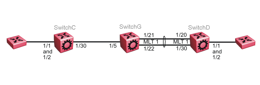

The following figure shows a sample greenfield deployment for SPBM.
![](GUID-060A5E02-8007-4544-9C94-EF4AD591BF97-low.png)
![Note](images/note.png)
For migration purposes, SPBM can coexist with existing SMLT configurations.
The following sections show the steps required to configure the Ethernet and MLT interfaces in this example.
SwitchC
PORT CONFIGURATION - PHASE 1 interface GigabitEthernet 1/30 encapsulation dot1q exit
SwitchG
PORT CONFIGURATION - PHASE 1 interface GigabitEthernet 1/5 encapsulation dot1q exit MLT CONFIGURATION mlt 1 enable mlt 1 member 1/21-1/22 mlt 1 encapsulation dot1q
SwitchD
MLT CONFIGURATION mlt 1 enable mlt 1 member 1/20,1/30 mlt 1 encapsulation dot1q

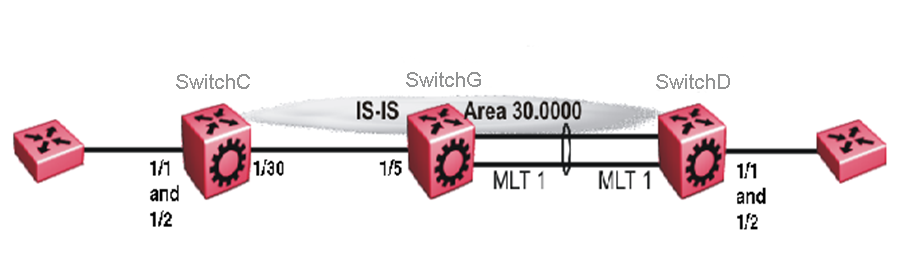

The following figure shows the IS-IS area information added to the network.
![](GUID-6B7EC7AA-4E6F-4B5A-AE5E-05DCC4ADE422-low.png)
The following sections show the steps required to configure the global IS-IS SPBM parameters in this example.
SwitchC
enable configure terminal prompt SwitchC BOOT CONFIGURATION spbm spbm ethertype 0x8100 ISIS SPBM CONFIGURATION router isis spbm 1 spbm 1 nick-name f.30.13 spbm 1 b-vid 20 ISIS CONFIGURATION is-type l1 manual-area 30.0000 sys-name SwitchC exit router isis enable VLAN CONFIGURATION vlan create 20 name "B-VLAN" type spbm-bvlan
SwitchG
enable configure terminal prompt SwitchG BOOT CONFIGURATION spbm spbm ethertype 0x8100 ISIS SPBM CONFIGURATION router isis spbm 1 spbm 1 nick-name f.30.10 spbm 1 b-vid 20 ISIS CONFIGURATION is-type l1 manual-area 30.0000 sys-name SwitchG exit router isis enable VLAN CONFIGURATION vlan create 20 name "B-VLAN" type spbm-bvlan
SwitchD
enable configure terminal prompt SwitchD BOOT CONFIGURATION spbm spbm ethertype 0x8100 ISIS SPBM CONFIGURATION router isis spbm 1 spbm 1 nick-name f.30.14 spbm 1 b-vid 20 ISIS CONFIGURATION is-type l1 manual-area 30.0000 sys-name SwitchD exit router isis enable VLAN CONFIGURATION vlan create 20 name "B-VLAN" type spbm-bvlan

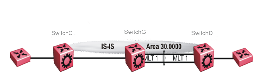

The following figure shows the IS-IS area information and interfaces in the network.
![](GUID-35FC74EA-4835-4CBA-9ADD-DD70B9DC9D97-low.png)
The following sections show the steps required to configure the IS-IS SPBM interfaces in this example.
SwitchC
PORT CONFIGURATION - PHASE II interface GigabitEthernet 1/30 isis isis spbm 1 isis enable exit
SwitchG
PORT CONFIGURATION - PHASE II interface GigabitEthernet 1/5 isis isis spbm 1 isis enable exit MLT INTERFACE CONFIGURATION interface mlt 1 isis isis spbm 1 isis enable exit
SwitchD
